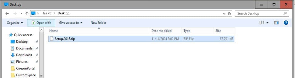

To begin the Cireson Portal setup process, first download the installer package for your System Center version from https://downloads.cireson.com. The download will provide you with a zipped installer file that must first be extracted.

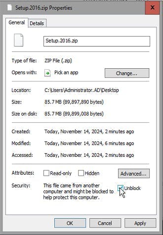

Before extracting the file, be sure to Unblock the contents to ensure there are no issues during the installation process. Right-click the file and select Properties, then check the box marked 'Unblock'. Click 'Ok'.

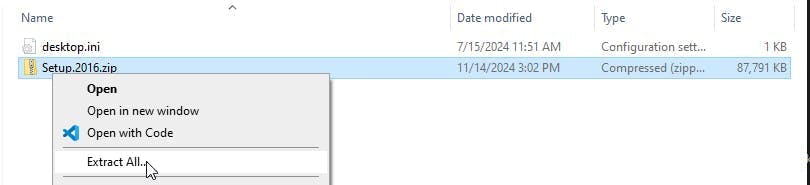

After unblocking the file, right-click again and select 'Extract All' and specify a location to extract the installer files.

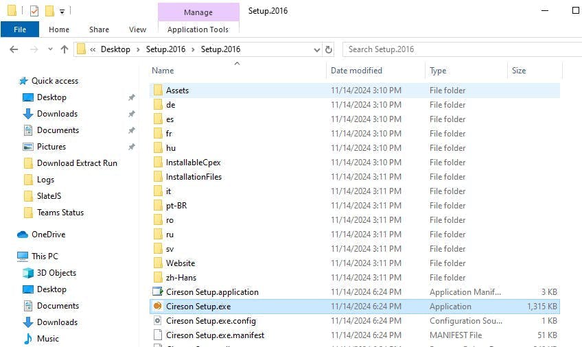

Navigate to the extracted files and locate Cireson Setup.exe. Double-click the file to run the installer.
