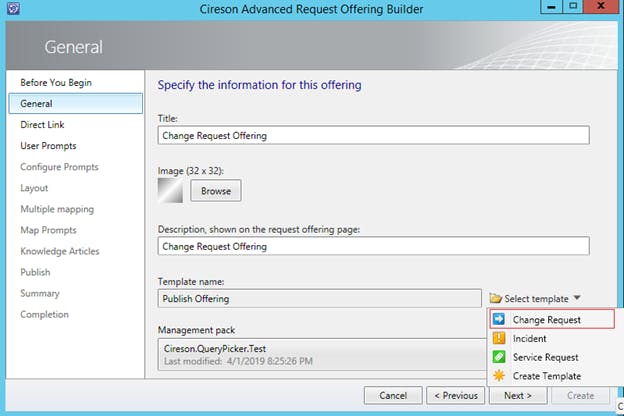

How to Create a Change Request Offering
To create a change request template based request offering, create an offering using the Cireson Advanced Request Offering Builder and select the “Change Request” option – which was added on the Select Template menu as shown below.

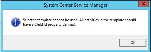

Known SCSM Issue
When selecting an out of the box change request template, you might encounter this exception: "Selected template cannot be used. All activities in the template should have a Child Id property defined."
This is a known SCSM issue and limitation. This is due to the way the activity templates were defined on the out of the box templates.
The workaround on this issue is to open up the template under Library->Templates, then edit and save every single activity attached to the Change Request. Once completed, you can navigate back to ARO and should be able to use the template.
