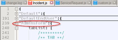

  • AD Group with Access: Enter the username of the group that you want to target the form at.
  • Form ID: Enter the ID of the form from the .js file. E.g in the below example the Form ID is AdminsForm
Note: The AD Group name and Form ID are case sensitive

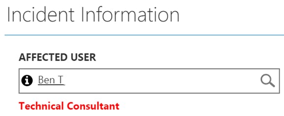

Changing the Style of the ExtraProps Label
Use this CSS override in the custom.css file to change the ExtraProps label style.
.help-block { color:red; font-weight:bold;}
