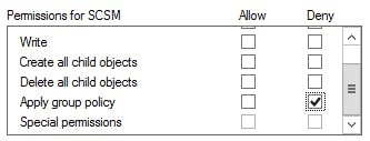

  10. In the permissions box at the bottom check the box in the Deny column next to Apply group policy.
  11. Click OK
