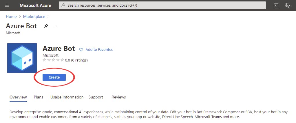

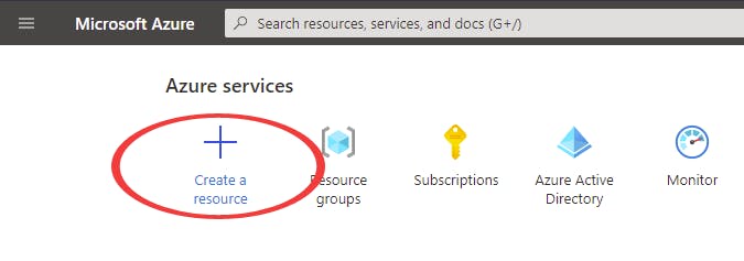

- Select "Create a Resource" in your Azure portal

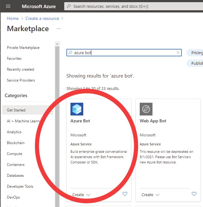

- Search for "Azure Bot" and then click it
- Click on Create

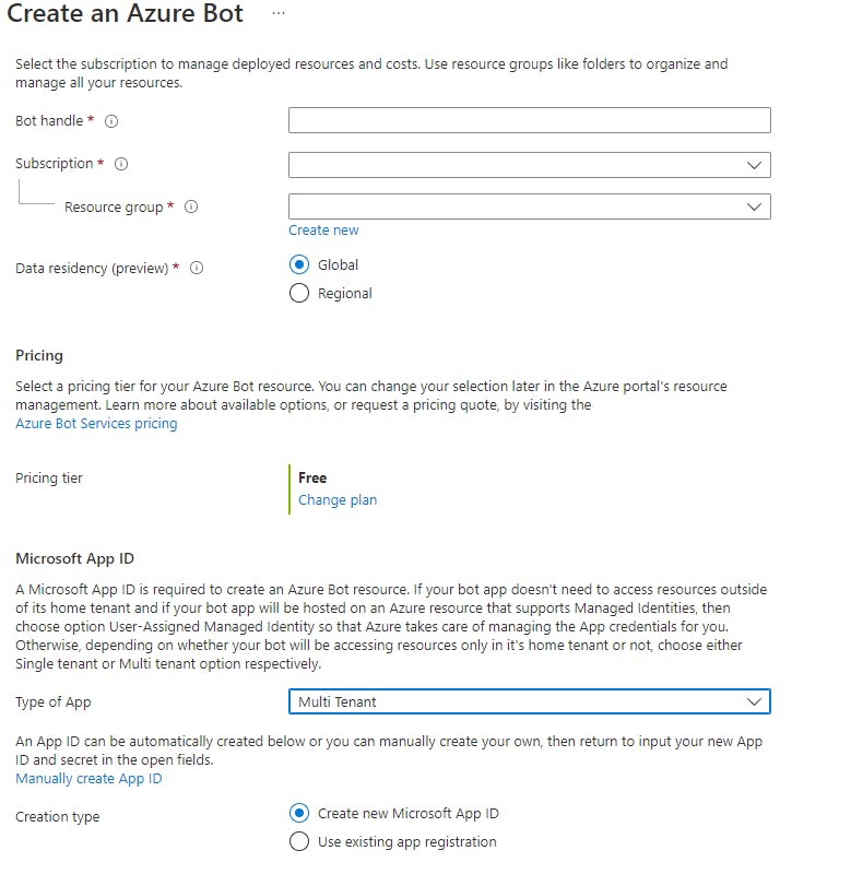

- On the next page, fill in the information needed to setup the bot.
- Bot Handle: This is a unique name across all Azure tenants and is different than the Display Name of the bot you will see in Teams
- Subscription: Choose which of your Azure subscriptions you wish to provision this resource in
- Resource Group: Choose an existing Resource Group or create a new one
- Pricing: Choose a pricing tier that works best for you
- Type of App: Use Multi Tenant
- Microsoft App Id: Use "Create new Microsoft App ID"

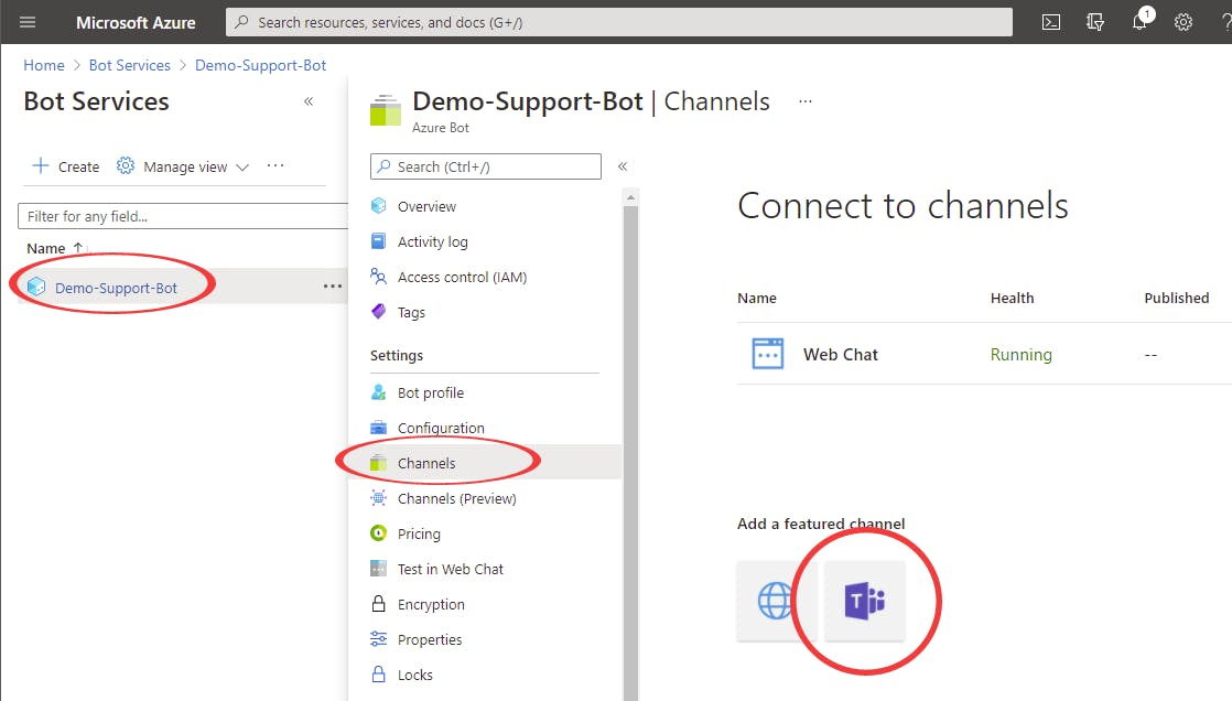

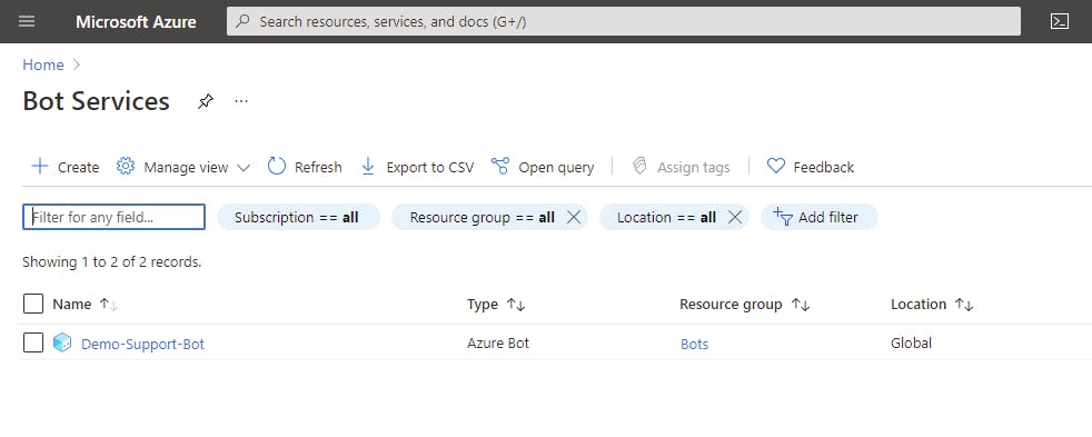

- Once successfully deployed, click on your newly created Azure Bot

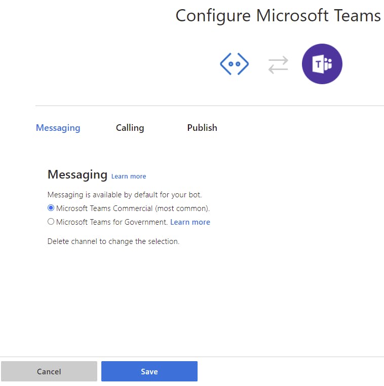

- Click on Channels
- Add the MS Teams Channel located under Featured Channels

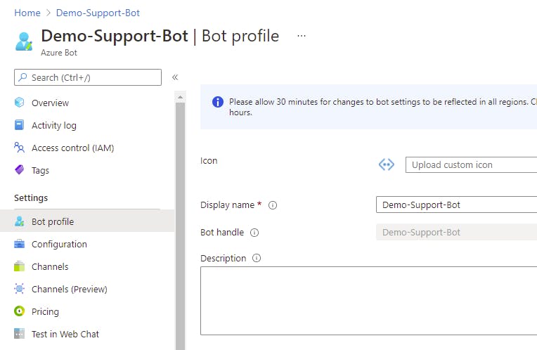

- Click on Bot Profile
- Set the Display Name of your bot to "SupportBot"

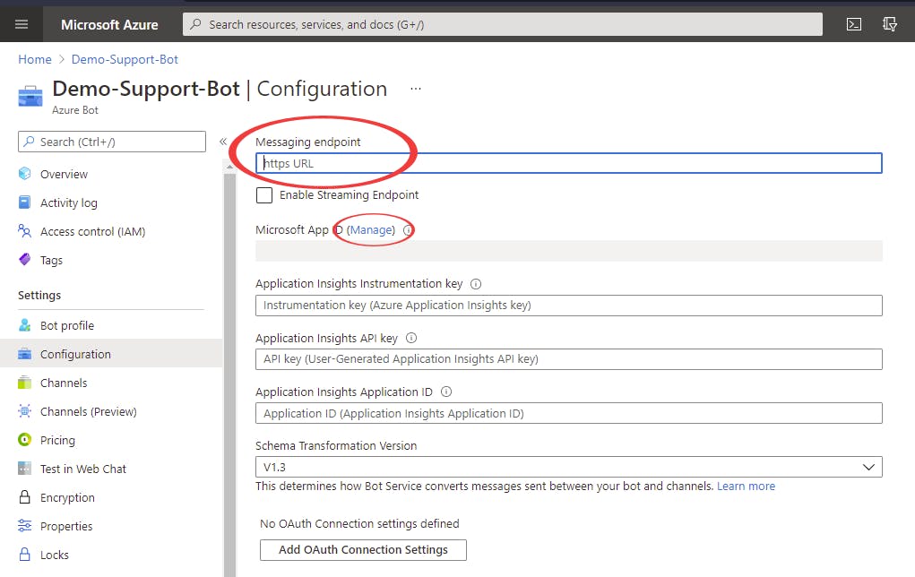

- Click on "Configuration."
- Messaging Endpoint: Enter the https://<smp-location>/api/teams/bot/messages location of your SMP instance, i.e. https://support.cireson.com/api/teams/bot/messages
- This endpoint must be HTTPS
- All applications that integrate with Azure require a unique App ID. When you created the Bot Service a new App Id was created and associated for you. The App Id is what ties the organization to the application that it is integrating with. In Azure AD it is possible to see all the enterprise applications you have integrated with. To configure you App Id click on Manage next to Microsoft App ID.
- Take note of the App ID located in the text box, you will need this to configure SMP

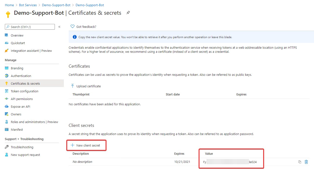

- Click on New Client Secret and go through the steps to create a secret key
- Take note of this, as you will need this to configure SMP (Note: You will only see this key once. If you lose it, you will need to generate a new key and update the SMP to use the new key)

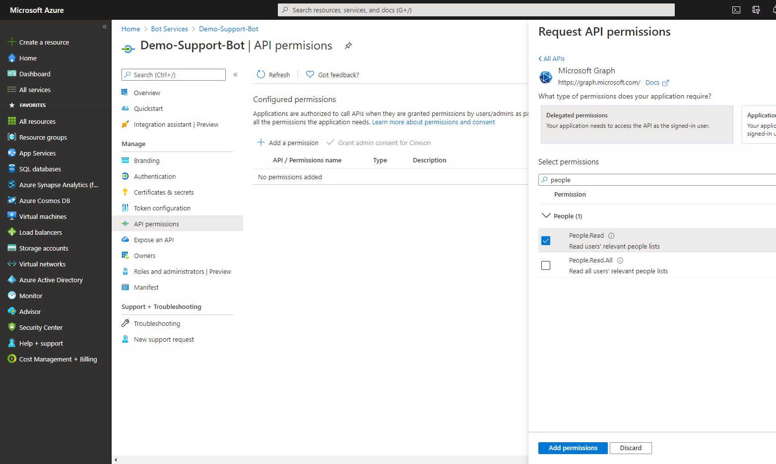

- Now that you have the info you need to connect your Portal to this App/Bot you need to set what permissions this app will be requesting. Click on API Permissions and add the following delegated permissions from Microsoft Graph
- People.Read
- Presence.Read
- Presence.Read.All
- User.Read
- User.ReadBasic.All
- People.Read
- Since you are an Azure Admin, you can now consent for this permissions for your organization, click "Grant admin consent for ..."

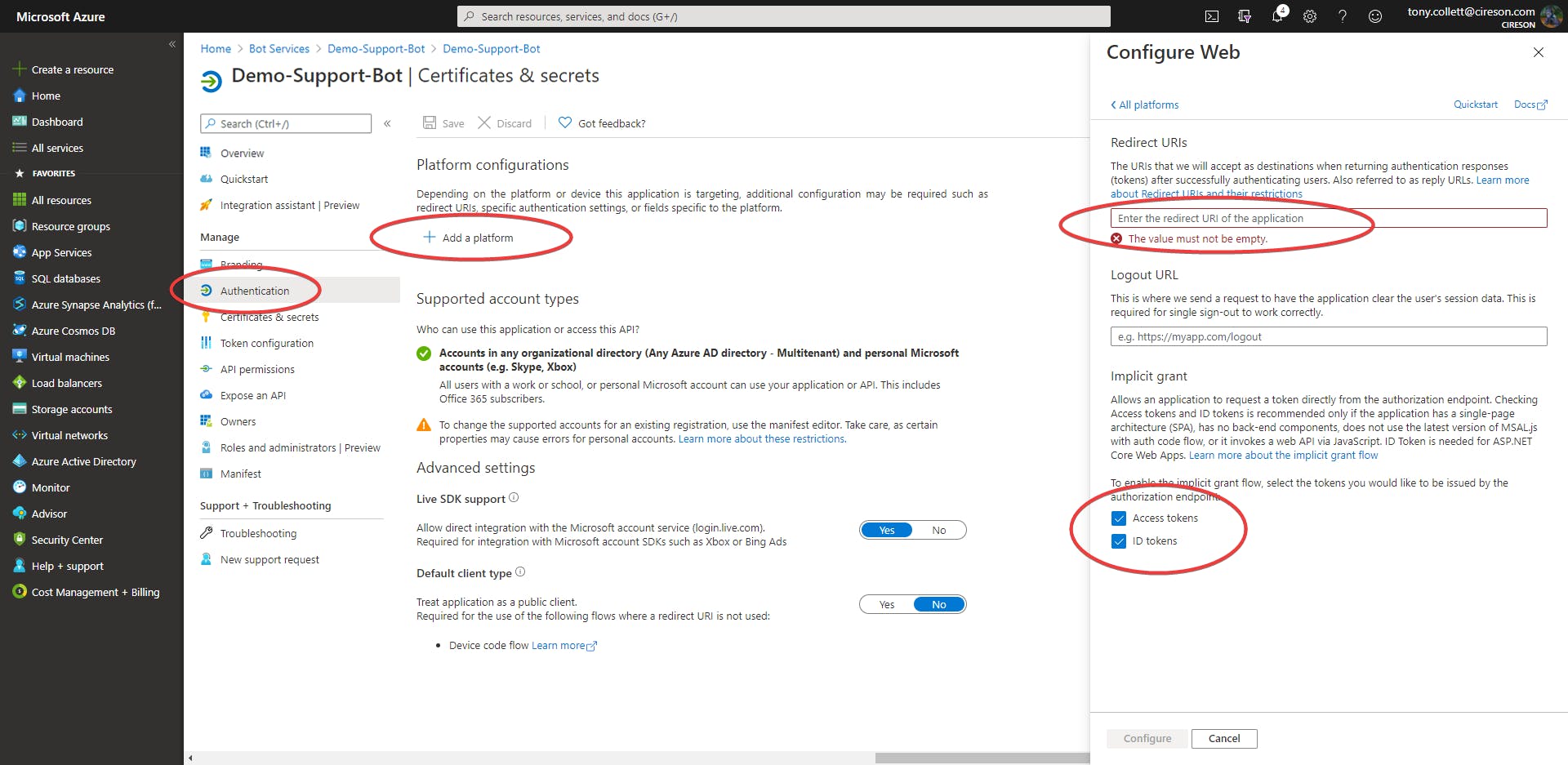

- Since Teams presence in the Portal requires the Portal user to also be authenticated with Teams/M365 we will need to setup authentication for this App as well. Click on Authentication
- Add the location of SMP under Platform configurations -> Web -> Add URI
- Enable implicit grant by checking the boxes next to Access tokens & ID tokens

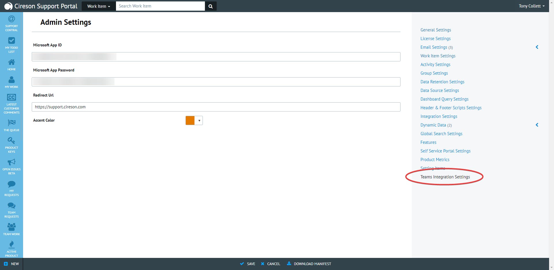

- Log into SMP, and navigate to the Admin section
- Click on Teams Integration Settings
- Enter the following pieces of information
- For Microsoft App ID enter the application ID you noted in step 10 above
- For Microsoft App Password enter the client secret key you created in step 11
- For Redirect URL enter the location of SMP i.e. https://support.cireson.com
- This must be a HTTPS address
- Click Save

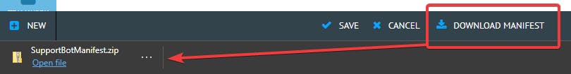

- Choose an accent color you would like for the Teams Bot, and click Download Manifest
- Save this file to a location of your choosing, this will be uploaded into MS Teams
- If you would like to change the default images shipped with the Teams Bot, please navigate to the zip file and overwrite the images outline.png and color.png in the package to the icons of your choosing

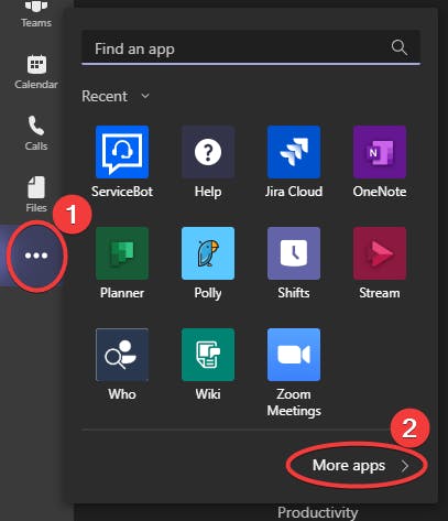

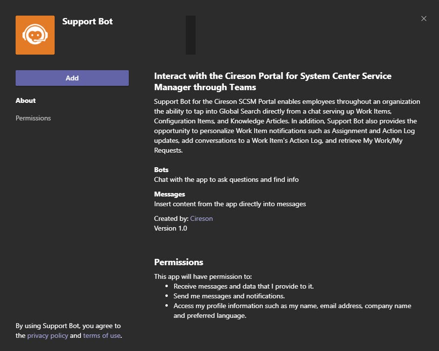

- Log into MS Teams and click on the overflow menu (...) on the left hand bar
- Click on More apps

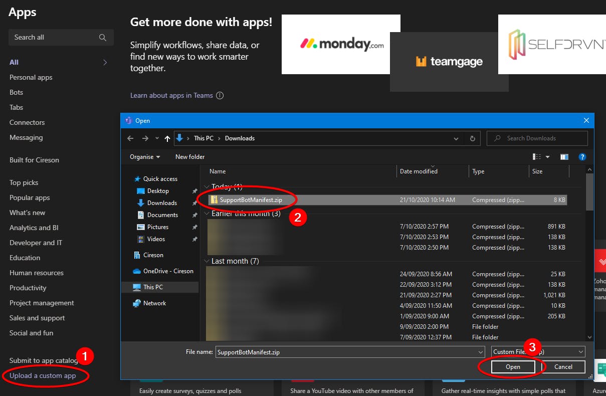

- Click on Upload a custom app and upload the .zip package you downloaded Step 5 of Configure SMP
- Click the Add button
