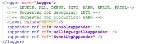

Changing the Website Logging Level
If you need to change the logging level to get more detail in the log, please do the following:
  • Open a text editor such as Notepad as an elevated administrator.
  • Open C:\inetpub\CiresonPortal\web.config.
  • Change the logging level key to ALL. Example shown below
  • Save the file.
  • Restart the Cireson Portal web site.
Note: Once you no longer need the more detailed level of logging, please change the logging level back to ERROR to minimize the impact of debug logging on performance and disk space consumption.

Changing the Cache Builder Logging Level
  • Open C:\inetpub\CiresonPortal\bin\Cireson.CacheBuilder.WindowsService.exe.config.
  • Save the file.
  • Restart the Cache Builder service.
