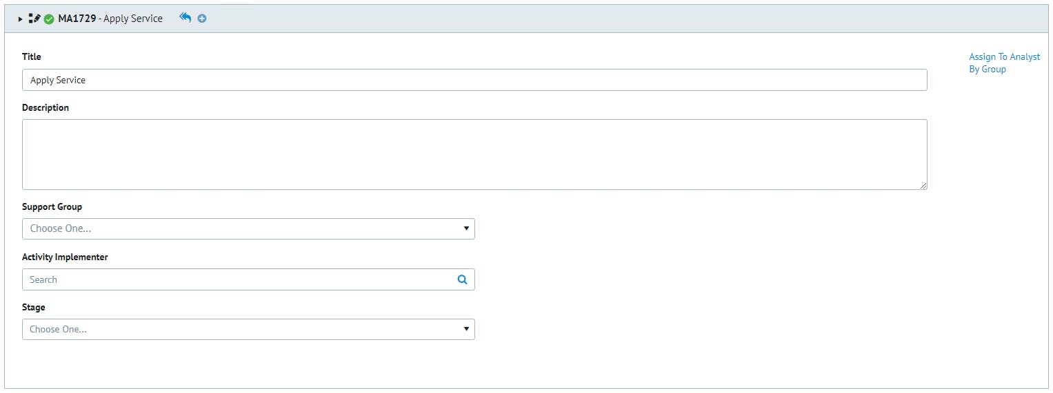

Simplified Analyst Activity form

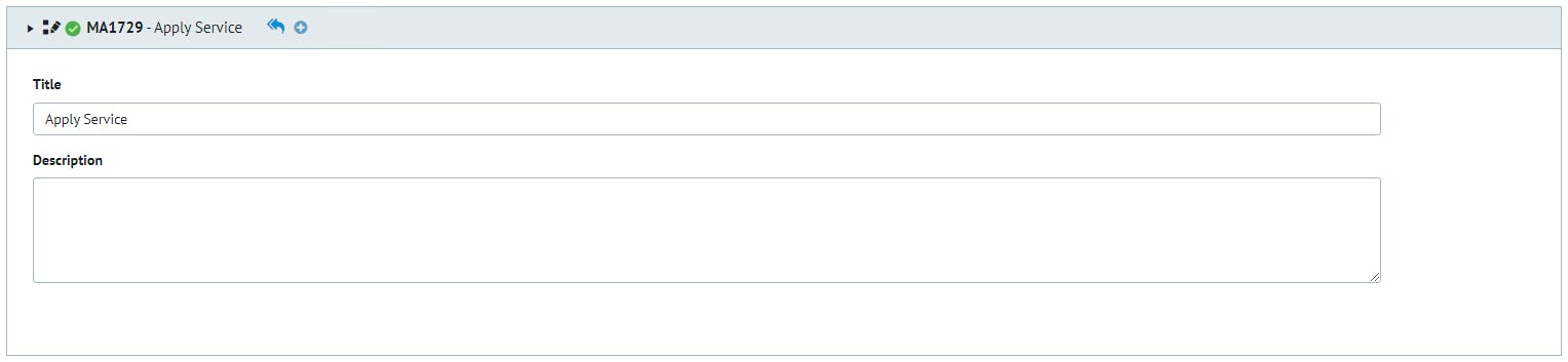

Simplified End User Activity form

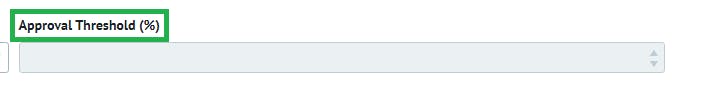

Setting which fields to hide
Note: Ensure you put into the settings the name of the field exactly as it appears on the form, NOT the name of the class property. You can the same field multiple times in different lanuages if needed.
