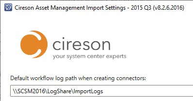

- Create a folder to store the Asset Import Workflow Log
- There is a recommended folder structure for SCSM and Asset Management in the Asset Management User Guides on the Cireson Portal.
- You will want to sort by “Date modified” when looking at log files in this folder so you can see the most recent one at the top
- Enter the path for the log file in Asset Import settings
- Administration > Settings
- It is recommended to share out the folder(s) you will be using for log files to the SCSM Admins and the Workflow Account. Then enter the URL for the shared path. Save this path to your local computer since it will be viewed often.

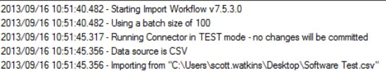

- Starting Import Workflow v7.5.3.0
- This line will display the version of the Asset Import app when the connector was run
- Batch Size
- In the Asset Import settings, the default size is 100.
- You may change it for initial mass imports, but you should change it back.
- You will get an error if you try to import more than that defined batch size.
- Running Connector in TEST mode
- If the “Test Mode” checkbox is checked, you will see this line noting data is not being written to your database.
- Data source is CSV
- Based on where the data was selected to import from, this will state it is from a CSV, SQL or ODBC source.
- Importing from…
- This line will display where the data is being imported from

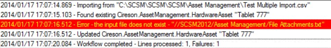

1-to-Many Relationship Mapping Logs
The following will show what the log may look like when importing a one-to-many relationship property.
You will primarily want to verify that the Lines processed = Relationships created. This way you will know everything was configured correctly in the import connector and associated files and referenced files.
- The input file does not exist
- Reason: The file has been renamed or moved.Â
