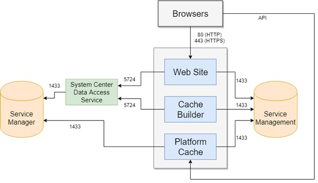

Portal Communication Flow and Ports

When setting up the Cireson Portal, depending on the authentication method chosen, there are different deployment topology options. Please see KB2439 for further details of Authentication Methods and how to enable each type
  • Integrated Windows Authentication - If you choose to install using Integrated Windows Authentication, the Cireson Portal must be installed on a server that is also running a System Center Service Manager management server.  The should be configured to connect to 'localhost' so that the will connect to the System Center Data Access Service that is running locally on the server.
  • Forms Authentication - If you choose to install using Forms Authentication, you may choose to either collocate the and the System Center Service Manager management server on the same server or to have the Cireson Portal on one server and the Data Access Service on a different server.
Note:  The Cache Builder service must always be installed on the same server as a System Center Service Manager management server.
recommends using a collocated Cireson Portal + System Center Service Manager management server for better resiliency and ease of management regardless of the authentication method.
