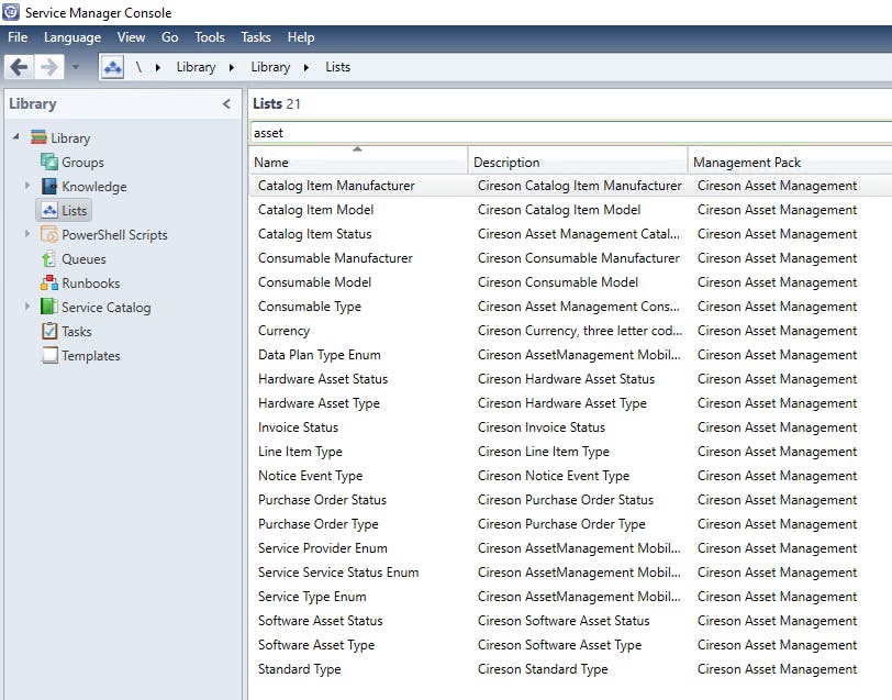

As part of the Cireson Asset Management solution, several lists are added to SCSM to populate drop down values of the asset CI’s. Like all lists in SCSM, the Cireson Asset Management lists can be found in the Library workspace under the Lists node.
Like any other list within SCSM, administrators are able to edit the contents of the list if required. If a list item is used by a template then the item will not be able to be deleted from the list, however it can be renamed.

To quickly find lists associated with asset management, filter the lists view with the criteria of “asset”
List of Lists
